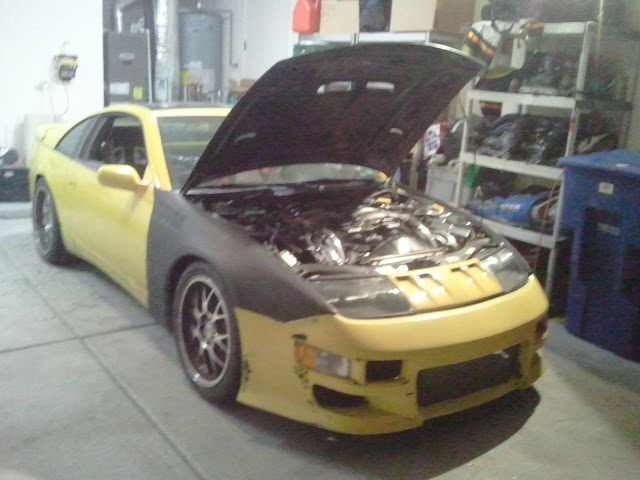

I had to remove the broken fiberglass front fascia while attached to the cracked fiberglass front ¼ panel. Part of the body was held together with zip ties. Other bolts were stripped & I was afraid of damaging the fragile poor fitting fiberglass body pieces any further than they were already.
Guess what was behind that? Godspeed horizontal flow Greddy Knock Off IC
Behind that is a high quality Z1 oil cooler & incredibly dirty poris foam “filters“.
Pretty dirty engine bay, with wires that are not intended for the heat generated in automotive engine bays.

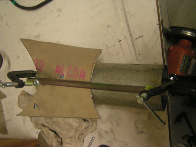

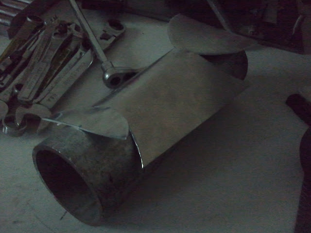

I drafted the end tank design in CAD (Vectorworks actually), printed it to paper, then confirmed it worked. I used that as my template to cut out the flat sheet aluminum. All the end tanks were formed using a variety of tools.
Cut out flat sheet aluminum.
The process started here.
They started to take form here
And here

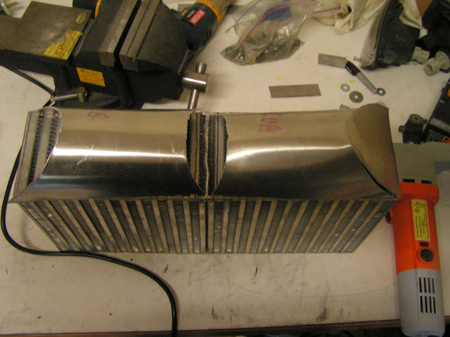

In the top view you can see where 2 cores were made into 1. Keep in mind this was an uber-budget build.
